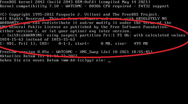

fritz.mueller
Munich, Germany,
22.11.2022, 12:06
Bug in FreeDOS FDISK 1.3.4 or BIOS?
This is shown by kernel when booting up till FDT2211
