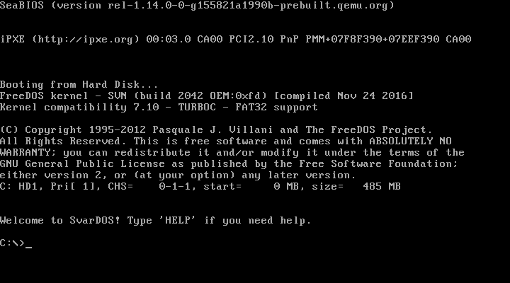

Book8088's CF2IDE stumps Freedos boot (Users)
Well, I tired multiple versions of 16-bit FreeDOS kernels on Book8088 2.0, but they all get stuck at InitDisk function. It seems that InitDisk has problem with CF2IDE and detects the wrong disk parameters.
It came preinstalled with MS-DOS 6.22 and that works ok. I just wanted to put something lighter like a slimmer version of FreeDOS 1.3 or SvarDOS.
Also, if someone knows: where should I report the bug so FreeDOS kernel people see it?

It shouldn't be the case. I tried multiple kernels with or without FAT32 support. Also, I'm not sure what was the original formatting, but I also tried FAT16 with only a system transfered with sys.com. I got the same results.
And the kernel actually recognizes the partition, but doesn't get CHS parameters right as it gets confused somewhere in the process. Than it gets stuck there.

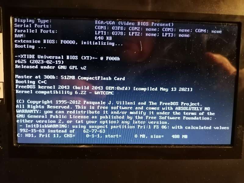

As pictures often make things easier to understand, could you take a picture that shows the kernel error messages. I am sure it will help Bernd Böckmann too.

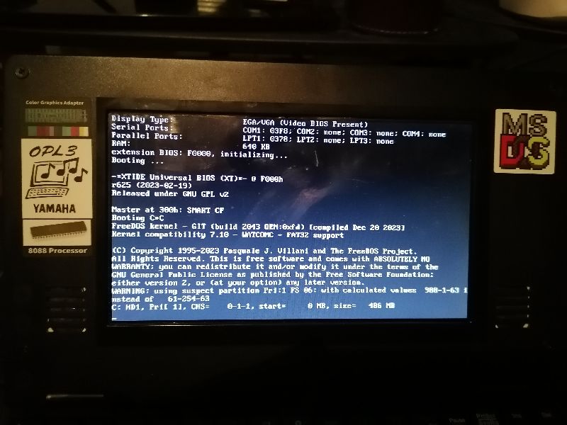

bocke
29.01.2024, 21:25
@ bocke
In case you can't see it from the screenshot, I transcribed the last two lines:
WARNING: using suspect partition Pri:1 FS 06: with calculated values 988-1-63 instead of 61-254-63
C: HD1, Pri[1], CHS = 0-1-1, start= 0 MB, size = 486 MB

Oh, you are here too. :) I just responded to you at the SourceForge Bug report few hours ago.
Sure, no problem. Just posted the pic and the transcription.
29.01.2024, 22:39
@ bocke
Hm, looks like typical mismatch when disk is partitioned and formatted with different CHS than readed later...
> values
Yes, deriving from the values in the screenshot, the CHS geometry under FreeDOS is detected as 16 heads, while it was formatted with a head count of of 255.
If the CF as a whole is less than 528 MB in size, 255 heads seems rather high, and 16 heads as reported by the XT-IDE BIOS is the "standard" one for such a disk size.

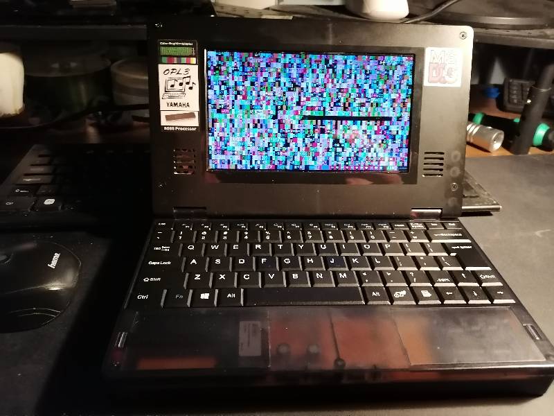

It prints out only:
" -Initdisk " and then goes onto to show this blinking light show:
I found some anonymous file host to upload a video of a boot:
https://ufile.io/0ivj391d

drive_0.img seems to be ok too. It boots fine in Qemu:
But, it doesn't work on the machine when written to CF card.

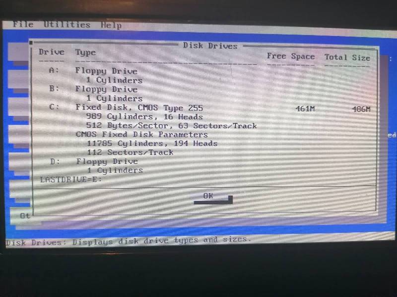

Offset 0x18 and 0x1A of the volume boot record, which should specify the sectors per track and head count, are zero. The partition table entry confirms that the partitions were indeed created under the assumption that the head count is 255. I did not see this either for such a small partition.
Would be interesting to see what INT13,08 (and 48, for completeness) actually return as geometry. Does anyone know a tool which simply dumps these values?

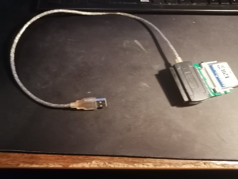

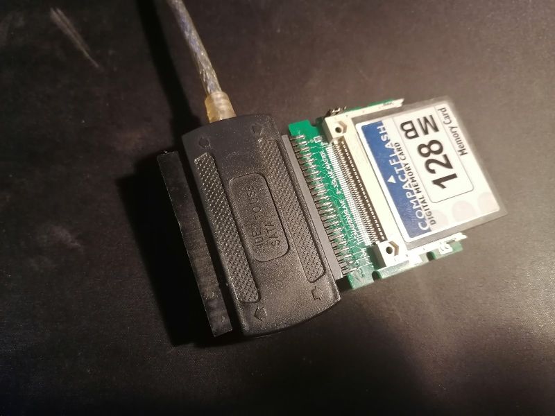

I use this:
[image] [image]
There are two things to this: IDE to USB and CF to IDE controllers put together. And this works well enough.
I had 2 card readers but they mysteriously "passed away" few days ago. Haven't yet got the replacements.
I guess this thing might be one of the reasons the images don't boot. But I'm puzzled that they work under emulators like DOSBOX-X and Qemu.
I'll get a real card reader in a few days and will try again.
I currently put away my DOS machine in the closet. Although I have a small itx machine with some older AMD SOC. I might try puting FreeDOS on it with legacy USB support. But if the problem is with CF pin order, that might not help either. :(
Is it possible to transfer DOS mbr and system (what sys does in DOS) from Linux? I found somewhere a script sys-freedos-linux from Eric Auer (from several years back), but I didn't have any success with using it. It does write a MBR into the root of the drive, but the boot stops after writing "Freedos" on the boot line. It doesn't pick-up the kernel.sys from the root of the drive.
> these values?
This is what MSD sees:
> of of 255.
> such a disk size.
If I remember well there should exist some ATA command to enforce CHS geometry on LBA capable drives. Probably Linux/hdparam can play with this too:
https://unix.stackexchange.com/questions/629411/is...ce-a-certain-chs-drive-geometry-in-modern-linux
But if the whole bootchain would use LBA (XTIDE? LBA MBR, LBA DBR, LBA partition...) then this problem shouldn't occur.

I have a Book8088 v2. I did some testing. I imaged the FD13BOOT.IMG from FD 1.3 Floppy Edition[0] to my slot on my Gotek formatted USB stick. I then used a Dell 316SX (a 386) with a Gotek FDD emulator & XT-IDE r625 to boot FD v1.3 over floppy. Next, I FDISK'd a 256MB CF card as FAT16 (CHS 984/16/32). Rebooted again to floppy and then ran `format C:/q/s`. I then copied a few binaries from the FD floppy to the CF card. Rebooted to verify the 256MB CF card would boot and it worked.
Finally, popped out the CF card of the 316SX and placed it in the slot on the Book8088. Booted & it worked[1][2]. See the pic below for reference.
No magic other than I've been working to restore the Dell 316SX so it now has a NIC with the XT-IDE r625 BIOS in it's ROM slot. The original 3.5" & 5.25" drives aren't spinning and I need to refurb those next.
You could try imaging a small (<2GB) USB stick with FD13BOOT.IMG and try booting off that as well [3]. It might take a reflash of the BIOS. They'll need to hit 'A' quickly to redirect XT-IDE to boot off floppy instead of the CF. I might test that as well.

> Please test if the 512 image works.
Unfortunately no. I get stucked at the same place:
