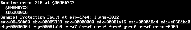

A bug in word wrapping option:
- when I open a new file and pick in "word wrapping" option, the program always crash.
Runtime error 216 at $0007A6A0
$0007A6A0
$0005A7B8
$00059E57
$0006094F
$00061AF3
$0005EDBA
$0005A967
CONFIG.SYS
device=himem.sys /testmem:off
device=emm386.exe RAM HIGHSCAN
files=20
buffers=20
dos=high,umb
lastdrive=z
devicehigh=a:\asuscd.sys /d:mscd001
devicehigh=display.sys con=(ega,,1)
country=034,,country.sys
AUTOEXEC.BAT
@ECHO OFF
cls
set temp=c:\temp
set tmp=c:\temp
path=a:\;
set comspec=a:\command.com
lh MSCDEX.EXE /D:mscd001
lh a:\ctmouse.exe
mode.com con cp prepare=((850) ega.cpi)
mode.com con cp select=850
lh keyb.com sp
set blaster=a220 i7 d1 h7 p330 t6
set sbpci=c:\sbpci
c:\sbpci\sbload
c:\sbpci\sbinit
- DOS 7.10 / Windows 98 (with Freedos also crash)
01.11.2007, 20:45
@ Rob
Blocek 1.33
Oj, thanks! It will be fixed immediately.
(For trees I overlooked a forest) :-P
