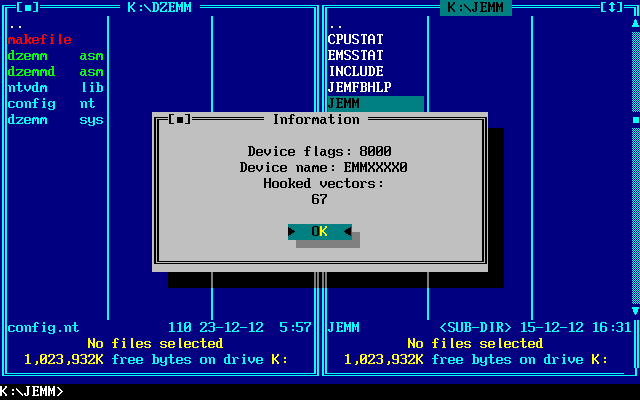

A new Expanded Memory Manager (EMM) for XP.
Download: https://sourceforge.net/projects/doszip/files/dzemm
Some differences in behaviour on this compare too the NTVDM's EMM:
Instead of the usual 16M of memory, this will give 256M. However, you may allocate FFFF pages to each handle, and there are 255 handles. There is no 1M-limit on copy, so you could copy 500M from one handle to another in one go.

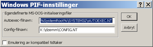

The update KB2724197 prohibits EMS in XP, and this program works best if this is installed (no EMS). If you already have removed the update, and install this one, it will still work, but the MS version will eat a lot of (all) memory. The manager will then "steal" some of this for its usage. You may right-click the shortcut for the DOS program, select Memory, and in the "Use EMS Memory" box, select none. This will prohibit the MS-EMM manager to install.

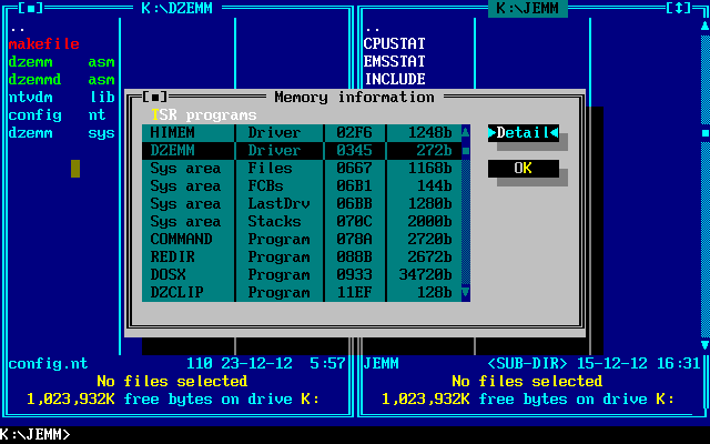

My curiosity lead me to try the driver. I saw that mem really repports 256MB EMS but it also caused problems to existing programs. When I run DN OpenSOurce 7.2.16 it crashed:
(it tells that NTVDM CPU got invalid instruction, Choose close/skip)
I actually use DN to test if the driver is installed, but that have to be a different version.
> So I quickly removed the driver from config.nt
For testing you may use a new shortcut, and set the CONFIG.NT to a local directory to avoid messing up the global settings.
I downloaded version 6.4.0 (dn640r.rar), and that crashes.
I looked at the code, and I think the size is a problem:

I tried new dzemm 1.01 and can confirm that DN works now. Maybe you can make a commandline option to tell how much EMS will be emulated.
