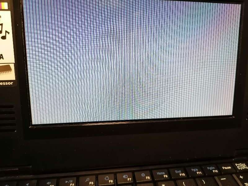

Went the furthest with 86_16:
![[image]](img/uploaded/image50.jpg)
But after this it shows vertical striped lines (?).
![[image]](img/uploaded/image51.jpg)

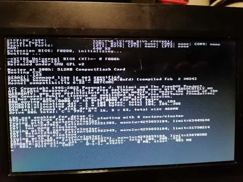

Edit:
I used the previously uploaded drive_0.img and did sys c: inside virtual machine, then wrote the result to CF card.
Edit:
I remembered that this image gave similar problems before (the one with a light show). That's the one that was a bit shorter than a card itself.
I'll try another one.
Edit:
I'm trying 512M image from here, next:
