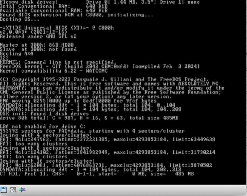

> > > Maybe related to https://github.com/FDOS/kernel/issues/84 (OW 8086
> build
> > > fails to boot)
> > I used the gcc compiled kernels that I host at
> > https://pushbx.org/ecm/download/fdkernel.zip or
> > https://pushbx.org/ecm/download/old/fdkernel/ -- Perhaps others can try
> the
> > kernel.sys file from those on the Book8088?
> I compiled it witch Watcom C. It boots in Xi8088 86box if only ecm's floppy
> is attached. If I attach my drive C image from a few days earlier, the
> kernel hangs on boot like when running on
> Book8088.![[image]](img/uploaded/image57.jpg)
I got a little bit further. GCC and Watcom C kernel hang on my previous image. HOWEVER: if I scatter around some printf in initdisk.c (ProcessDisk()), the Watcom kernel boots fine with the image (have not tested GCC).
So my assumption is that the stack gets corrupted. I am not yet sure where exactly...
Here is the link to the image: https://nextcloud.iww.rwth-aachen.de/index.php/s/rtJRKk6ifYY8kRo
It still contains the EDR kernel, so 86box has to be booted for example with ECMs diskette.img.
